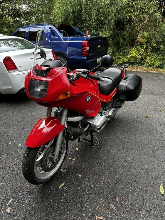

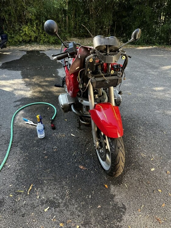

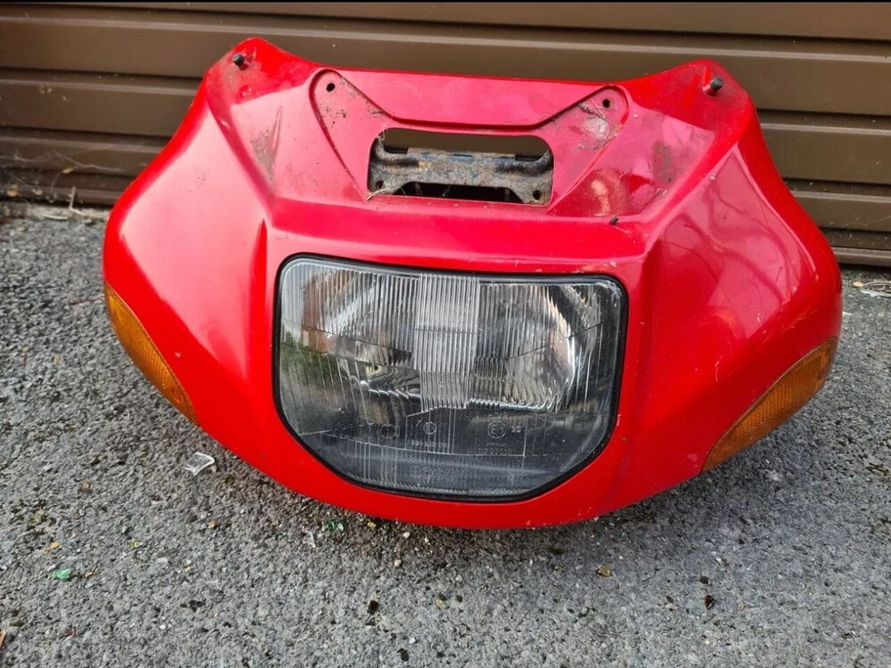

Long time no see on this one.  The fairing has been incredibly difficult to source, but about three weeks ago one turned up in the UK in great condition.  I bought it and had it shipped over.

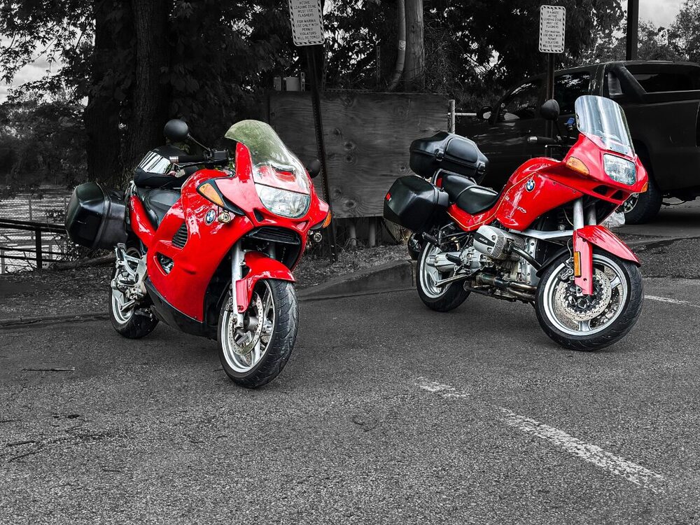

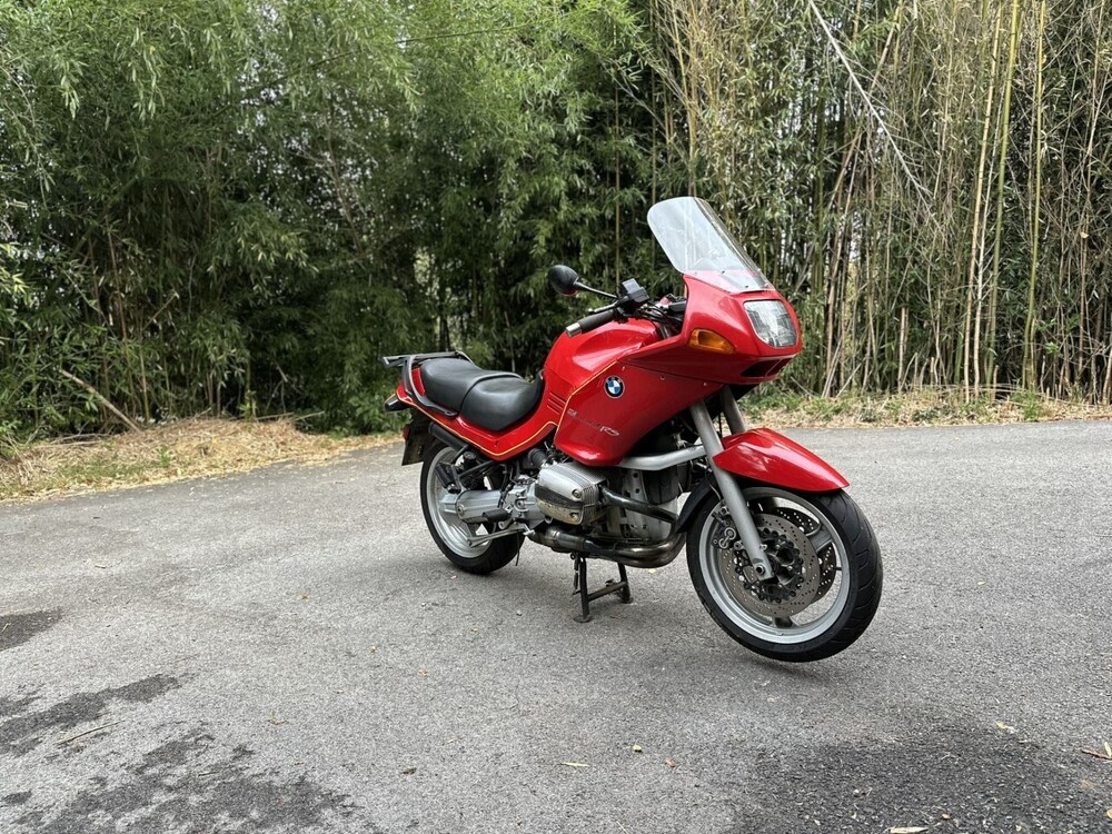

On Saturday, I rode 2 1/4 hours out to State College, PA, area on my 2019 BMW R NineT Scrambler to test ride some Moto Guzzi bikes. After riding there for a few hours, I rode the 2 1/4 hours back.  The seat on my NineT is horrible for long-distance riding and by the time I got home I was exhausted and everything hurt. Some of the Moto Guzzis were touring bikes and were really comfortable to ride, making me think that I might like having a touring bike instead.
But wait.... I already HAVE a touring bike.  So as soon as I got home, and before I even got my riding gear off, I went and pulled the R1100 RS out of storage, put the battery back in, and it fired up.
By Sunday, I started cleaning the grime and grease and finished up like this.
Yesterday I ran around getting some bulbs, small parts, and fluids for a fluid change, but you can't do a fluid change on these bikes until they've been ridden for at least 20 minutes and then cooled for 20 minutes.... so, my next step was clear.  Put it back together.
As of last night:
I took it for a short shakedown cruise this morning and it ran great.  It still needs the fluid changes, and I'm going to replace the valve covers (I already have them), and a few other odds and ends, but it's getting pretty close to being ready to ride.

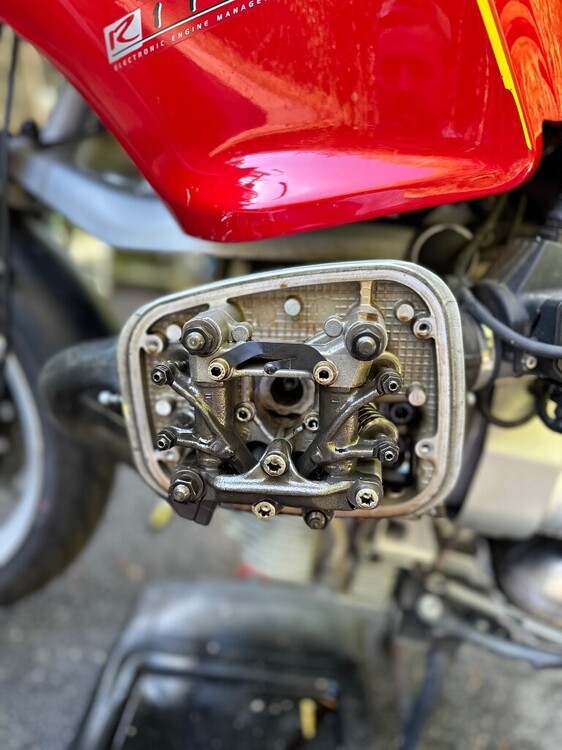

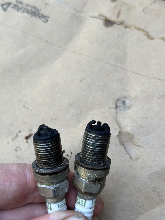

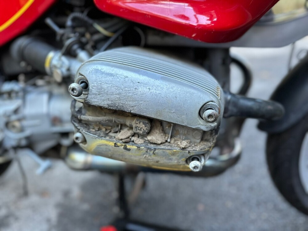

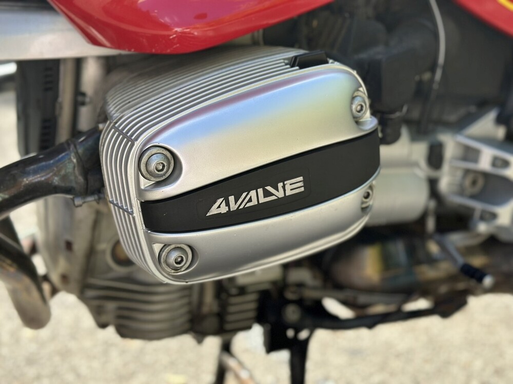

Did a valve adjustment. I also replaced the valve covers, valve cover gaskets, and spark plug covers. It looks like I should probably do spark plug wires, but it’s not yet urgent.
I think these plugs, like the battery was, are original. The bike is 25 years old and has 108k miles.
Ready for a test ride, it got its first drink in who knows how many years. Ran perfect for the 6 mile trip.
Once I get it home from Costco, I’ll let it cool 20 minutes and then change the oil, transmission oil, and rear drive oil. The oils in these is thick and needs to be warmed up to drain properly.
How it started:
How it's going:
Funny story - apparently those spark plug covers with the "4 Valve" silver lettering have been out of production for years and you can only get reproductions with no lettering or black lettering.  I knew I needed a set way back when I first bought them and grabbed them on an e-bay auction randomly only because I thought they looked better than the plain ones. I didn't realize I was grabbing something made of unobtanium.

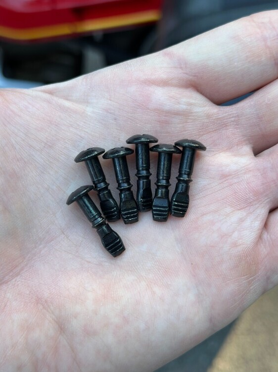

Additionally, @smk4565 would be quite proud that I purchased the proper bolts that are vastly superior German engineering.
$5 per bolt for a screw with one end hammered flat. That's $30 worth of screws in my hand, but they're the only thing that works properly to keep the front lower fairings in place.  BMW did want another $4 per rubber washer, but I got the dimensions of them and bought a 30-pack from Lowe's from the plumbing repair shelf for $3.97.

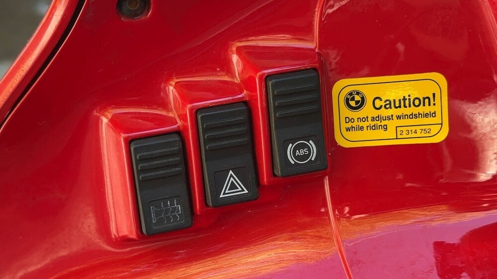

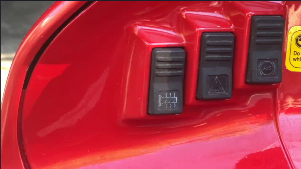

These dashboard switches have seen better days, beyond the obvious wear, their switching action didn't work well.  I found the hazard light switch and the ABS disable switch on E-bay for $25 each. I still need to find the headed grip switch.
Looks and works so much better.

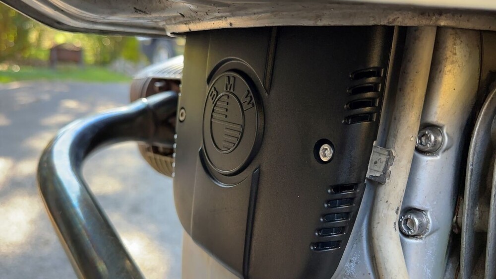

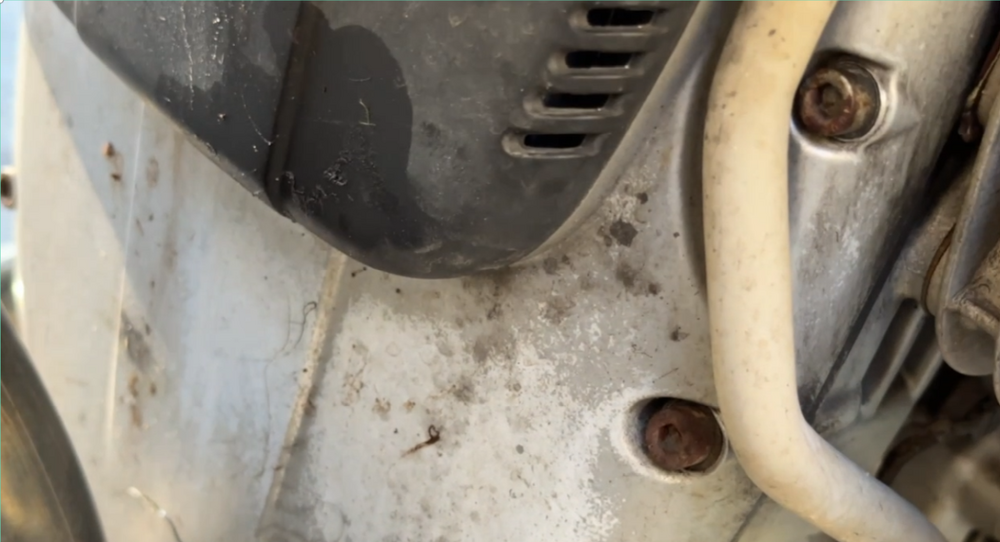

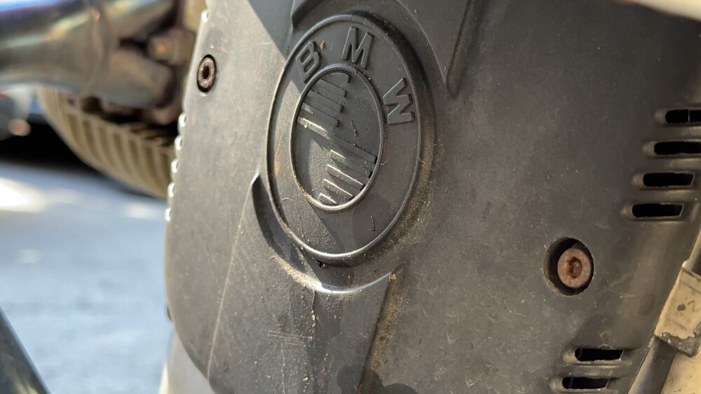

I'm also starting to do detail cleaning in small batches.  I got a set of motor bolts for the engine breast plate and alternator cover.  I swapped out the bolts, cleaned up the alternator cover, and hit it with the Meguires Back-to-Black. I'm not going for perfect, just better.
To this....
Taking off the breast plate involves removing the exhaust, which I'm not going to do this season, but I would eventually want to repaint it.

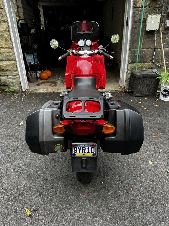

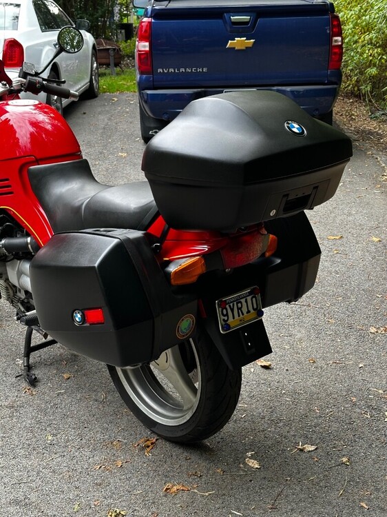

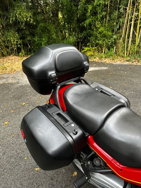

side quest success! I got this top case from a guy in Philly for $200. Similar online run $399 plus shipping. The downside was that I had to drive out and get it.
This one has a padded back rest for Albert to feel more comfortable. I recoded the lock core to match the other bags and the ignition, so now one key opens it all.
I have new key blanks coming so I can have a spare, but I’m going to have to find an oldschool locksmith who can cut it because they are odd shaped keys. The local bmw dealer is way too new and won’t have key equipment for a 25 year old bike.
