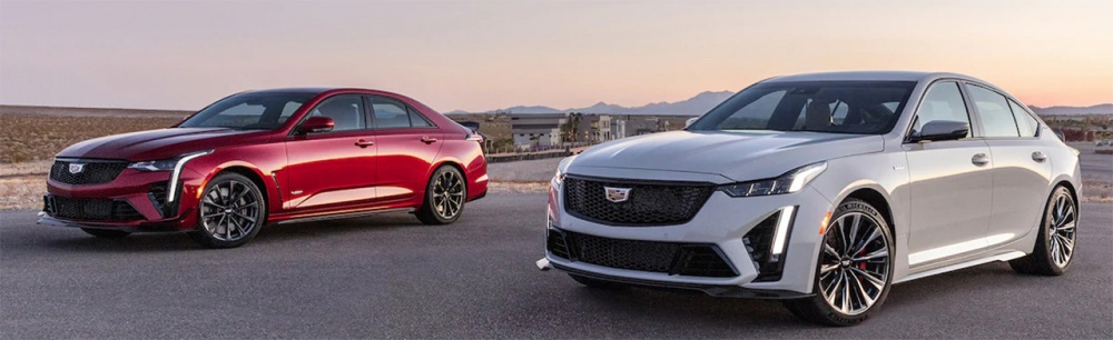

With the new CT4-V and CT5-V, Cadillac has returned to big power:-
  • CT4-V Blackwing gets 474 bhp / 445 lb-ft Twin-Turbo V6 (LF4)
  • CT5-V Blackwing gets 668 bhp / 659 lb-ft Supercharged Pushrod V8 (LT4)
This is definitely welcomed news for Cadillac V-Car fans who were completely underwhelmed by last year's CT4-V and CT5-V that boasted a whopping 10~25 hp gain over ordinary CT5 cars and base model Silverado pickups. The return to Pushrod power is encouraging, showing that GM is finally playing to it's architectural strength rather than chasing after other manufacturer's design weaknesses.
Still, it begs the question as to why Cadillac (or GM in general) decided to downgraded the 3.0TT (LGY) engine for the CT5 from 404 bhp to 335 bhp (360 bhp in the CT5-"V*") which saved no money, gained no compression, gained no torque and gained no mpg over the same engine in the CT6 (LGW). It also represents a missed opportunity to evolve the promising 2.7T engine. The 2.7T -- as I have previously articulated -- could easily have made 420 bhp @ ~5300 rpm / 420 lb-ft @ ~2800 rpm with about 20~22 psi of boost from properly sized turbocharger like a G25-550D while providing markedly better drivability than any AMG 2.0T engine of similar output by virtue of its 36.5% greater displacement. It would have been a fitting powerplant for the CT4-V Blackwing and it would have captured the 4-cylinder performance crown for GM.
This also confirms the abandonment of the hot-Vee 4.2L twin turbo DOHC V8 (LTA) used in the short lived CT6-V and which GM had declined to employ in the new Escalade, CT5-V Blackwing or any other suitable vehicle -- a total waste of R&D and tooling dollars.
