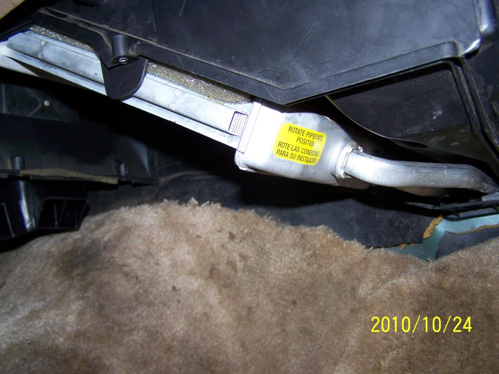

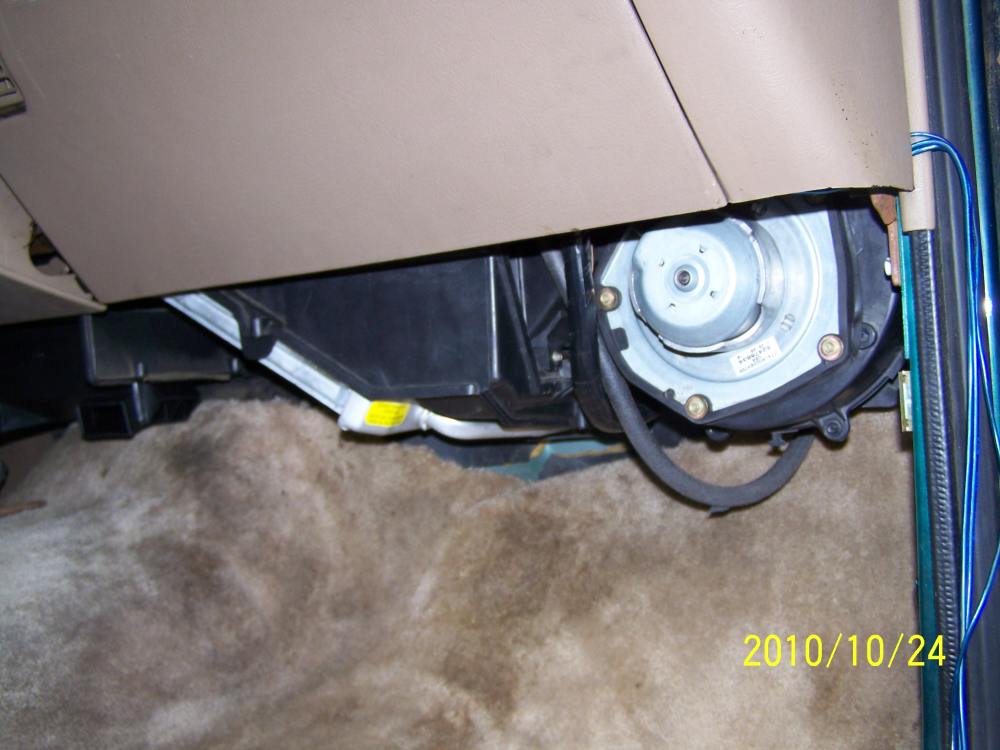

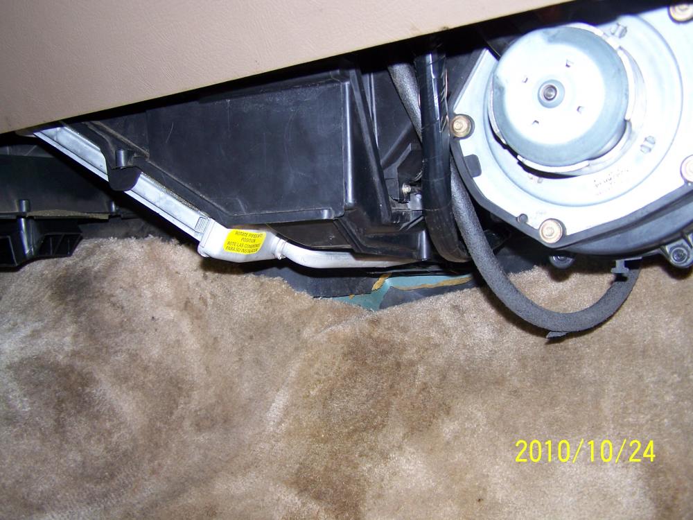

But the biggest problem is that the previous owner screwed things up quite a bit. I'm just fixing each problem as I identify it, at this point I don't know if the heater control panel is at fault or the actuators. But the air doors are not doing what they should be doing and I am not getting enough heat in the system. The blower motor also stops now and then for no good reason.
You might try a couple of things, Camino. First of all, you might use NO-Lox on the connection to the motor, after you clean the connection.. It will keep moisture and corrosion out of the connection, and ensure that it isn't corrupted in the future.
IF one of the ducts isn't collapsed, I'd bet you are not getting enough RPM's out of the motor, or tht an old motor doesn't have enough torque to turn the blower wheel at the proper speed.

-The blower motor problem is likely to be the resistor - known issue with these.

- My main suspect is the control panel (a very expensive part).The plastic housing has been damaged for sure, and I suspect the circuit board to be bad.
-The previous owner claimed to have "just replaced" the heater core (and it does look new), but I don't know what else he screwed up. Considering that he removed to of the levers that connect the actuator to two of the air doors (I replaced them today), anything is possible.

Now I have just the lack of enough hot coolant flowing through the heater core (which may correct itself with some miles), and the intermittent behaviour of the fan motor (likely the resistor).

The heat issue may be crud in the heater core, I suspect that the previous owner didn't flush all of the Dexcool out before he used the green stuff. The heat level is improving now.
The last major problem is either the blower motor and/or the resistor.
